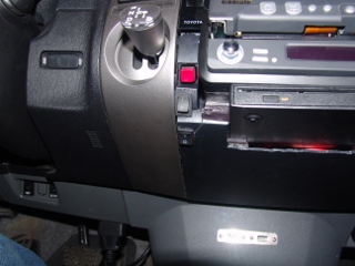

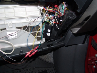

    I have finished my installation of the ACTH.
    I placed the circuit behind the glove box. Its easy to access in case I need to adjust the fake temperature.
    I placed the on/off switch below my car PC on/off switch. Its easy to access while driving.
    After I put everything back together I tested the circuit and it work just fine. Now I don't have an ugly box and switch hanging on my dash. :D
