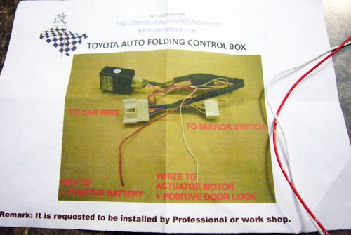

    Holy smokes, you've done it! So basically splice same colors together from custom harness to car harness and the two power folding wires to pins 9 and 10? how does the module communicate with the passenger side mirror? Splice into same pins 9 and 10?

    It's pretty easy. Pins 2 - 8 on the OEM connector are the same wires as 2-8 on the controller connector. Pin 1 on the controller harness is empty so that tells u which way the #s go. Pin 9 & 10 on the controller harness go to both folding mirror motors. I still haven't figured out where the red & white go.

    When you're saying "controller connector", you're meaning the connector on that custom harness we received that says "to car wire"? If Pins 9 and 10 on this controller harness go to bother folding motors, how are we supposed to connect them to those pins? Run a wire from where on the driver mirror to Pin 9? and from where on the passenger mirror to Pin 10? Have you asked Mitaccessories where the red and white wires go? or do we need to shoot him an email and ask him?

    Yes, that is what I'm calling the controller connector. That connectors pin 1 is empty. The next pin is 2. Now pin 2 - 8 are tapped to the same corresponding pin # on the cars harness.
    I'm not sure what ur body guy did but nothing should have been changed to the mirrors harness. The only thing different should be that there are some loose wires. I have the following wires coming from inside my mirror:
    1) a grn & blue wire for the folding motor
    2) 3 wires for the signal & pilot light
    3) 2 wires for the puddle light
    It's the grn & blue wire from the folding motor that go to pins 9 & 10.
    I have not asked Eddie to confirm where the red & wht wires go.

    Oh I get it. He replaced all the internals. All I did was add the motor for the folding. Either way.....ur fine. That connector that he replaced isn't available in the US, just Japan. The wish mirror had 7 wires (3 for mirror movement, 2 for signal & 2 for folding motor). What needs to be done is u can either get a 2 pin connector for the folding motor and have it near the OEM mirror connector or use butt connectors. Then just run those 2 leads (from each mirror & splice/tap into pins 9&10 on the controller harness. Does this make a little more sence?
