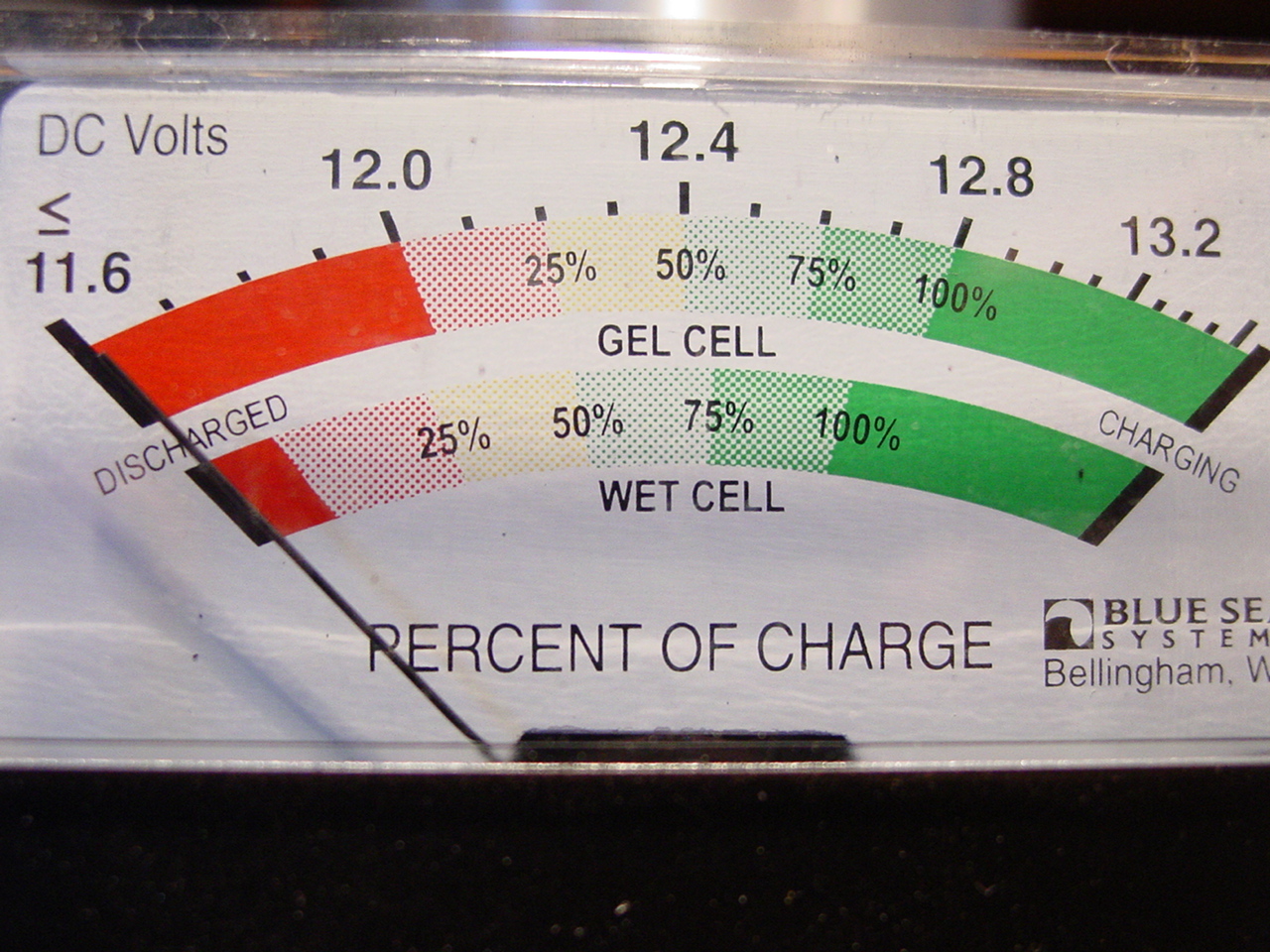

    What is your reference for this information, or the source of the chart?
