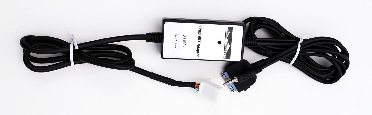

    Unfortunately I was unaware of this forum before I attempted a DIY a few months ago with basically zero knowledge. I purchased this:
    which I thought I could just plug into the CD changer slot on the back of the stereo and it would be exactly what I wanted. First problem was this product has the smaller 6+6 pin that the newer Prius' have instead of the 5+7 which my gen I has. Next, although my Prius doesn't have a CD changer in it already something was plugged into the CD changer slot. When I remove it the clock doesn't work as others have mentioned.

    Now the clock and radio still works (which is great) but when I plug my iPhone or MP3 player into the adapter I can't switch to the CD changer because it says there isn't one connected. My phone will charge but just not communicate with the stereo so at the very least I have a $23 car iPhone charger. Is there a way for me to "trick" it into thinking there is a CD changer connected so I can get the audio from the aux adapter? I don't need the Nav screen controls to work for the phone as I will just be using an MP3 player but it would be a nice cherry if I could.
    In the meantime I've left everything connected and the adapter is hiding in the glove box. I've gone back to using the cassette adapter which has good audio quality but the clicking noise is annoying if I don't have the stereo on loud enough. I'd rather not purchase another stereo or adapter and I really like the idea of DIY projects.

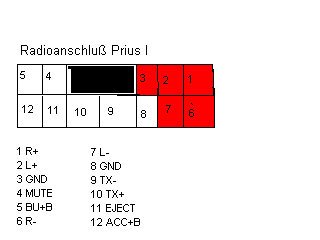

    Since I splced the wires and soldered them without using a y-adapter I would have to unsolder everything to check this. I too am curious so I may try it but won't have time to today. One thing I noticed is in my previous picture showing the 6+6 to 5+7 conversion, on the 5+7 plug there is a TXT wire which is not existent on the 6+6 and there is a wire on the 6+6 that is not labeled as anything at all. What is the TXT wire and could that be what I'm missing? The gadget doesn't use the unlabeled spot anyways (as show by the red x on it).

    I'm not getting very far deciphering what you've drawn in that Paint screenshot. The reference that finally helped me out installing my Dice box was this:
    and sure enough, pin 11 was key to my problem ... the Dice harness had crossed it with one side of the AVC-LAN, which meant two things: the AVC-LAN communications were all disrupted, and any tape I inserted would immediately eject. :)
    But I don't think that's causing your problem, if (as I think you're saying) you left it unconnected. You'll probably notice the first time you want to eject a tape, though.
    -Chap

    What I drew was the colored wires of the device (6+6 pin) so I would know which wires to solder together (since I didn't buy a y-adapter). You're reference is the same as the one I have on the right of the paint screenshot except pin 11 is marked as eject instead of "TXT" and signal ground on mine matches ground on yours (same thing I guess). I drew x's on pins 1,2,3,6, and 7 because they weren't currently being used by the Prius, which looks the same as your reference which has them colored red.
    I just need a way to trick the Prius into thing there is a CD changer connected, like a switch or something. It turns out that is more complex than I was hoping, which is the whole point of these devices I guess and why the dice products are $100+.

    Well, they weren't currently being used, but I hope you did connect 1, 2, 6, and 7 to the right and left audio outputs of your gadget anyway, or even if it had successfully shown up as a CD changer you wouldn't hear much. :)
    That's done by messages over the AVC-LAN (pins 9 and 10). The master sends out "hey, who's out there" and your gadget says "me, me, I'm a CD changer", and shows up in the device check list. We saw that it did get as far as showing up in the list, so that's something ... but with a status of NCON, which seems odd. Unless it showed up correctly once and then disappeared, and the MFD remembered and wondered where it went.
