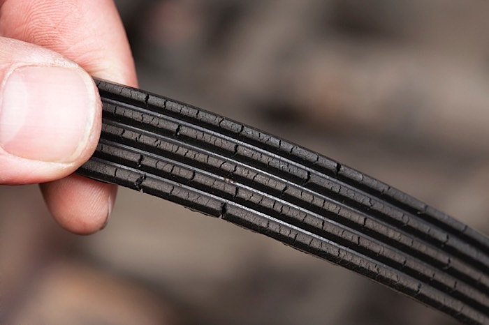

    Changed my auxiliary belt on my gen 2. Old one was very cracked and glossy, hence it was slipping too. I wasn’t experiencing any other belt-related issues, but thought I’d replace it before issues arise. And old one was a non OEM belt. Pleasantly surprised by how easy it was to replace.

    The belt looked like this:

    Definitely time to replace. Did you check if the water pump and the adjusting pulley spun smoothly and quietly?
    If the bearings sound "dry" (like old school roller skates) then I replace the pulley (or pump).

    Yes, all smooth at the moment.
