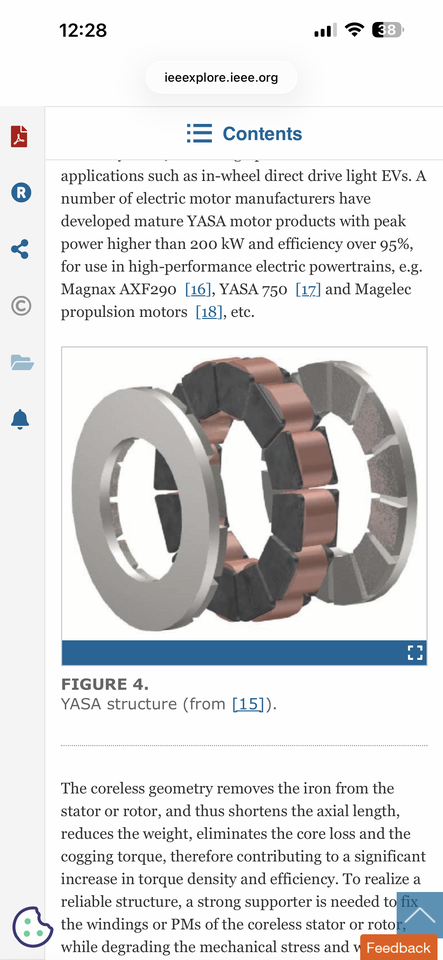

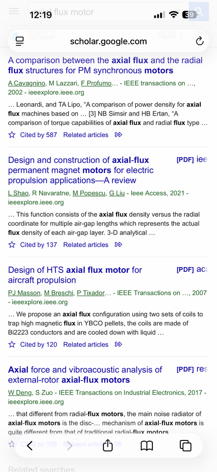

    My general approach to interesting technology is:
    • Munro Associates - for over 10 years, I have found they are adept at finding promising products and leads the rest of traditional manufacturing.
    • IEEE papers found via Google Scholar: IMG_0786.png
    After skimming the abstracts, this one appears promising:
    https://ieeexplore.ieee.org/abstract/document/9627679
    Having once been plagerized, I won’t ’cut and paste’ someone else’s work. But if offered for a fair price, I pay or ask permission. This is an article I would readily pay for and cite.
    There is a rich taxology of axial flux motors and skimming, this article appears to be a good start.
