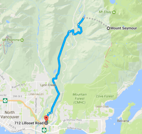

    This is the only time I use it:
    Any flatland or short hill application is a waste of time, and bad for mpg.

    Gosh, that's REALLY steep. I'm amazed that even the B function can cope. I'd never try to drive down a hill that steep. You must be insane!
    And how do you make it back up the hill? No car could get up there, apart from maybe a Land Rover with a winch. Bits of it are beyond vertical!
    Oh, wait.... Is this picture taken from above?
    That's OK then.
  20. Trollbait
    23,725
    12,814
    It is possible to pull up the elevation changes of a route in line graph form in the Googel Earth app.
    RCO likes this.
