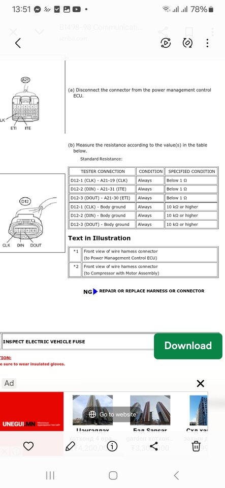

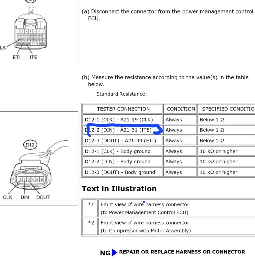

    When I tried to measure with this instruction, the DIN ITE would not connect. It is not possible to connect with a double wire.
