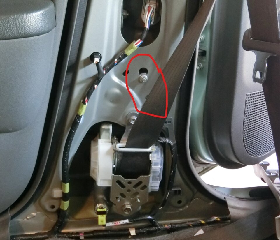

  10. PriusOwner428
    PriusOwner428 Junior Member
    Feb 5, 2022
    85
    IL
    If I'm reading the error code correctly, it looks like the likely culprit is either a potential sensor in the back of the passenger seat, or something behind the red circle in the pic
