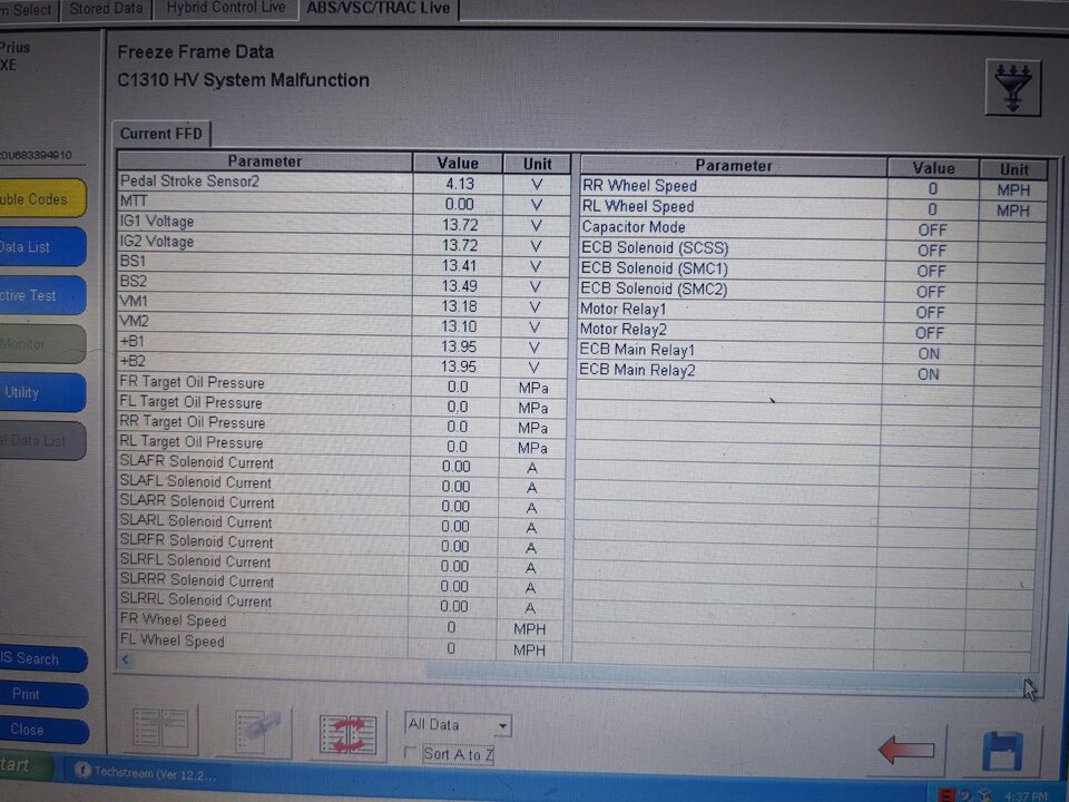

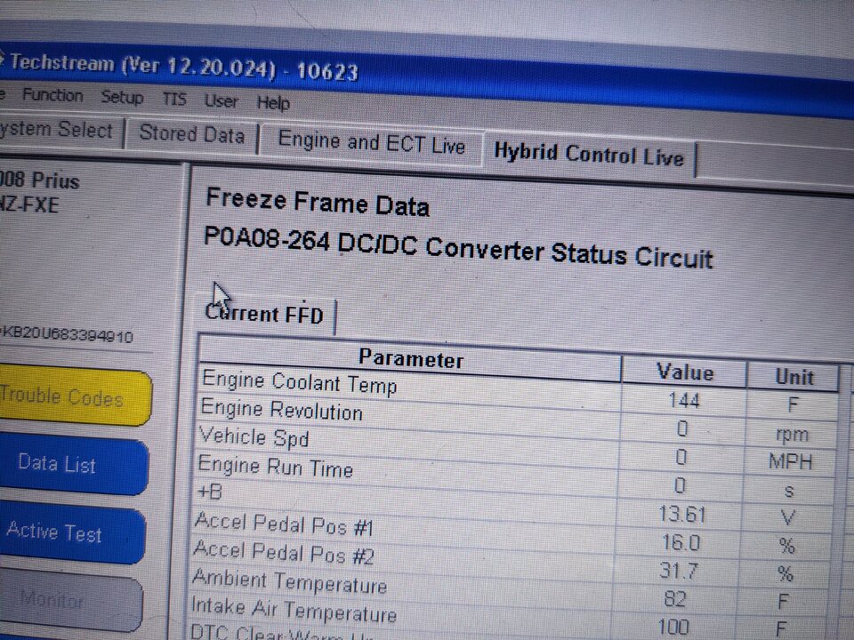

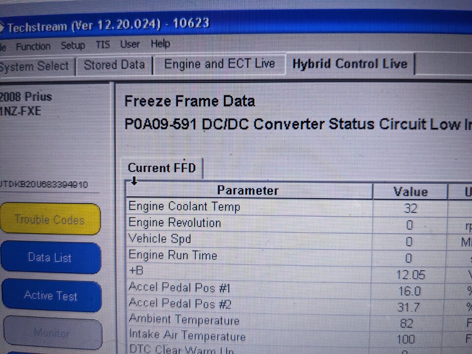

    It's running!!! After about 4 tries. The fob is sync'd.
    Now it is displaying the following codes:
    C1310
    POA08-264
    POA08-591
    PXL_20251004_203733114.jpg PXL_20251004_191325920.MP.jpg PXL_20251004_191228904.MP.jpg
  10. ChapmanF
    28,721
    19,020
    Yay progress!
    Search around for threads about your P0A08 and P0A09 codes. They pertain to a simple signaling circuit between the HV control ECU and the DC/DC converter, and there's information in other threads about troubleshooting that.
  11. TwoPriusInTenn
    Nov 27, 2015
    254
    66
    Tennessee
    All solved! Final fix on the P0A08 and P0A09 codes. The 5 amp fuse located in the positive battery cable tested good, but wasn't long enough to make a good connection. All good - no triangle. No codes! Thank you everyone!
