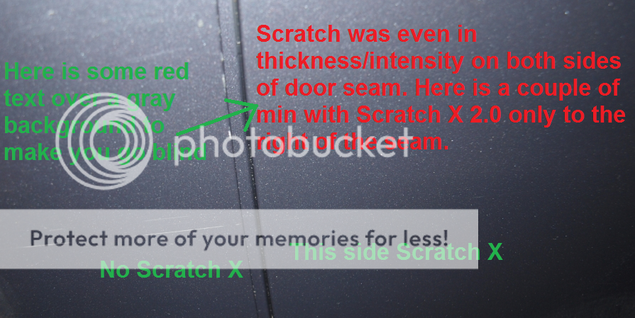

    OK, here is a scratch I did not do! Wife said it was there from when something hit the car. Here is before and after and I clay barred it after so there is absolutely no haze/material left in the scratch to the right. This stuff really seems like the real deal. Thanks for the advice! You really cannot see this now unless you're looking for it and bending around from crazy angles with the light just so and even then maybe not.

    Okay...
    Please...listen to me. I've been detailing cars for 15 years...I'm very experienced and know what I am doing. Scratch-X is an abrasive polish...it does precisely what you are describing, the goal is to round off the edges of the scratches so that they don't reflect light in the same way, and hence become invisible. If you have hazing or dulling where you've used the Scratch-X, then you have not worked the product down enough or allowed the abrasives to diminish properly.
    First of all, always buff parallel to the scratch, not perpendicular. You also don't want to use too much, you need to polish with the product until it diminishes completely beneath your towel, otherwise you will get that hazing you described.
    I would recommend a cotton terry cloth towel for working the scratch-X in, and a good quality microfiber towel for buffing any residue off.
    Bear in mind that the areas you use the polish on will need to be waxed again. I personally would (and do) work the polish into the areas of concern and then follow up by putting a coat of wax on the whole vehicle. Never wipe in a circular motion that creates swirls, always in straight lines.
    You can probably achieve what you want with the Scratch-X, but if you don't use it properly then you can make the situation a lot worse...you can't really do anything that will permanently damage the paint without a machine...but you can create hazing and areas of more headache for yourself.
