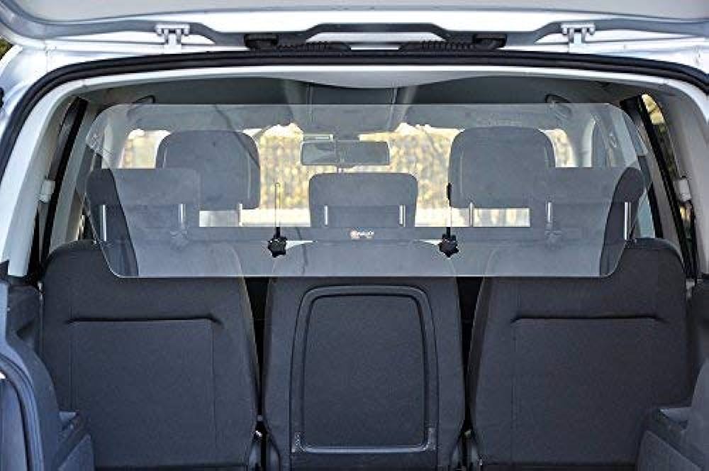

    Looking for recommendations for a pet partition Between the cargo area and the backseat for my gen 3 It needs to be strong and nontransparent enough so people riding in the backseat don't know my dog is back there. Thanks

    I don't know if any commercial products that are opaque. However you could make a template out of thick cardboard to get the shape correct and then have a piece of plexiglass cut into that shape. Plexiglass can be anchored in place with L brackets and small nuts and bolts. Then use the anchor points for the rear tie down D rings to attach the new plexiglass divider to the car. Black plexiglass is available or you could go with clear and just paint it. Vent holes are also an option for good air flow.
    Sneeze Guards For Cars | On Sale Today | DGS Retail
    kinda like this.
    Or this one....[​IMG]

    I like that sneeze guard idea
    How do you secure it?
