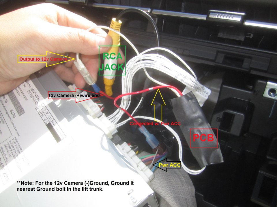

  8. NoMoreNow
    NoMoreNow Member
    May 13, 2013
    167
    102
    SF Bay Area
    If you brought the T-Harness like mine, here is pic for my setup...and should be connected as follow.
    **Disclaimer: Not responsible, if you mis-connected.
    quickbike likes this.
  9. quickbike
    quickbike Member
    Aug 3, 2013
    39
    26
    Sacramento, California
    Dude, this totally helped me out! My camera is finally working correctly! Thanks, I'm also from the bay as well, I just moved to Sac though :(
