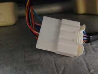

    SF Bay Area
    Thanks. I will take your route through the left kick panel, headliner is not the way to go.
    I have some problem removing the middle section plastic panel under the hatch (under the wiper).
    In the Toyota Manual Ref. no. AIM 001 911-1, on page 17 of 30. It shows pictorial diagrams of 31, 32, 33 and to 34.
    The pictorial diagram is missing a middle section panel removal procedure after 33. It went directly to diagram 34, which is the bottom panel.
    My guess is that the 2012 Prius model, the construction of the plastic panel is a bit different than the previous year. So, it did not show the additional middle section panel.
    How did you remove the middle plastic panel without breaking the panel?
    Here is some picture of the middle and bottom panel. View attachment 45316 View attachment 45317 View attachment 45318 View attachment 45319 View attachment 45320
