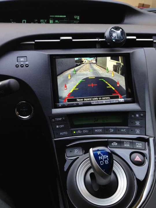

    All for $42; what a deal! I notice you put the view screen on your dashboard covering your radio, etc. Do you just put that there when needed; thus giving you access to the buttons most of the time?

    No, the monitor that shows the image. I don't have a monitor built in. Does the camera connect wirelessly to a monitor that you purchased or is this your nav screen?

    The camera kit only comes with the camera and a transmitter that connects to the navigation monitor. The monitor you see in my picture is an Alpine 8" indash navigation system.

    The guide lines, are they fixed straight or do they bend when you turn the steering wheel?

    they are fixed

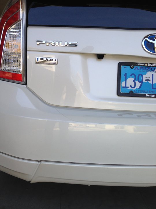

    T-taped positive wire to back up light and negative wire to any bolt.
