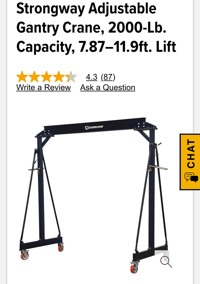

  5. rjparker
    rjparker Tu Humilde Sirviente
    Jun 6, 2008
    11,133
    6,982
    Texas Hill Country
    Gantry as in Gantry Crane
    Tom uses voice to text and swing sets for gantry cranes.

    I cannot have wheels unfortunately.
