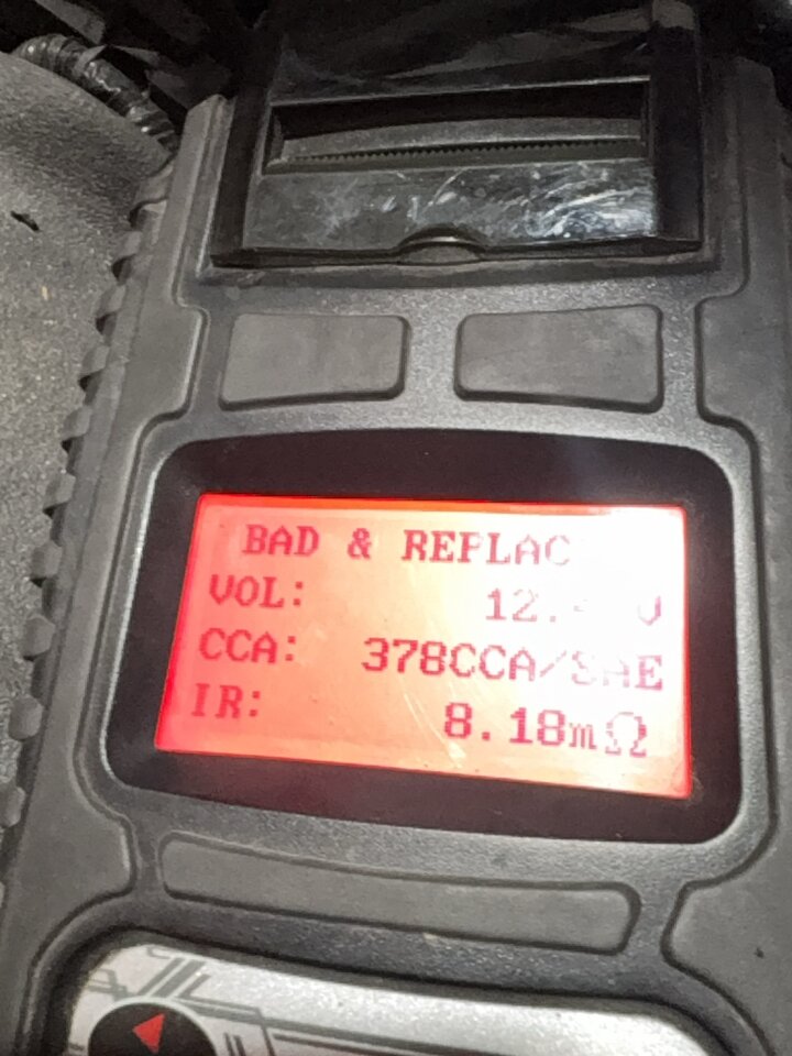

    I got my oil changed yesterday and the tech informed me my battery should be replaced. I thought 12.4V was okay? Maybe the other values are the reason?

    It's good; this car will start all the way down to 11VDC.
    Check the electrolyte levels and recharge if needed. If it's going to fail, it'll probably do it on a cold winter morning. You can use a cheap jump pack to get it started. If your nervous about it, replace it.

    Dealer battery tests measure the "starting amps" which is the maximum current that the battery can deliver. It is an indication of battery health, but has little relevance for a Prius. We do not use the 12v battery to spin start the engine. Our 12v battery just needs to run a couple of pumps and initialize the Prius electronics which is a much lower current than starting a non-hybrid car.
    My 2020 Prius battery is 5 years old and the dealer has flagged it for replacement for 2 years. It still reliably starts my Prius and I will replace it when the resting voltage falls below 12v and /ordrops more than a volt under load (headlights on).

    According to his picture, it's still outputting >375CCA - more than enough to do it's job. The highest draw on that battery is the ABS and Evap test routines; everything else runs with the DC-DC converter turned ON - unless you kill it by leaving it in ACC mode.

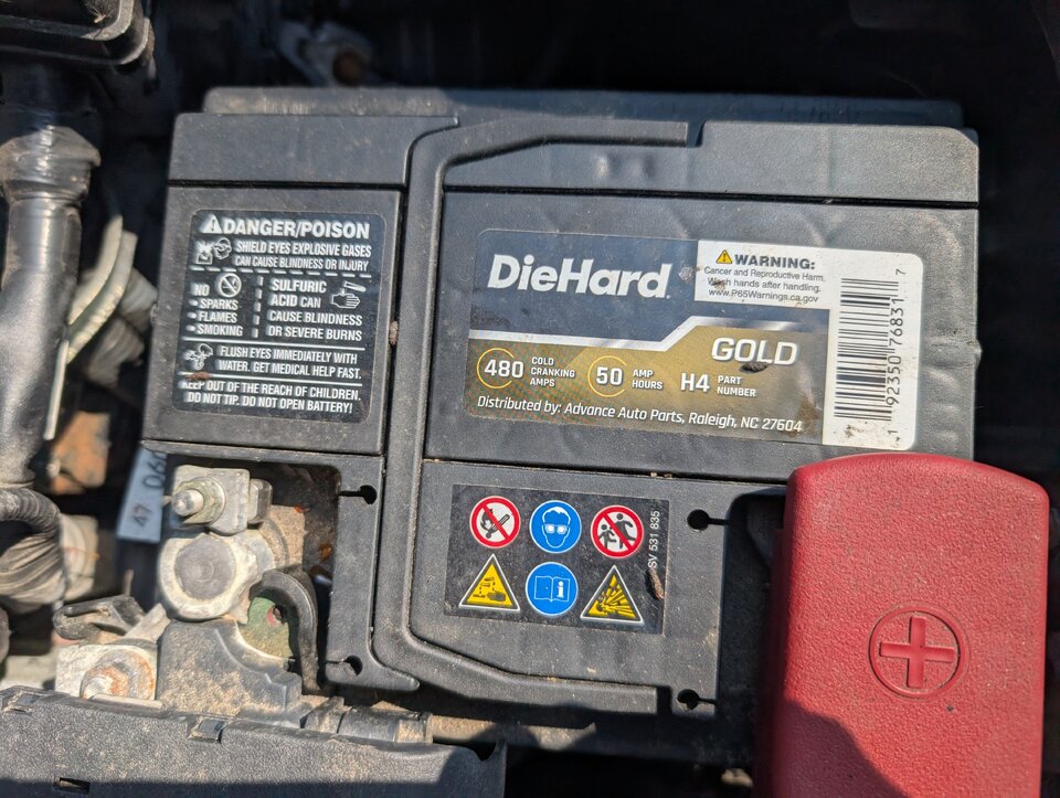

    can you post a picture of the top of this battery. The 378 CCA value would be good, for a 3rd gen, stock AGM. Stock 4th gen battery is conventional, flooded-acid battery, perhaps with similar CCA spec. Your replacement is possibly the same, or compatible aftermarket option. With similar CCA spec, or perhaps higher.
    the criteria for replacement is typically CCA dropping lower than spec. While the battery is not called upon to “crank”, measured CCA spec is still a good indicator of the battery’s viability.
    say for example the replacement battery has a CCA spec of 450, then measured 378 would indicate a deteriorating battery.

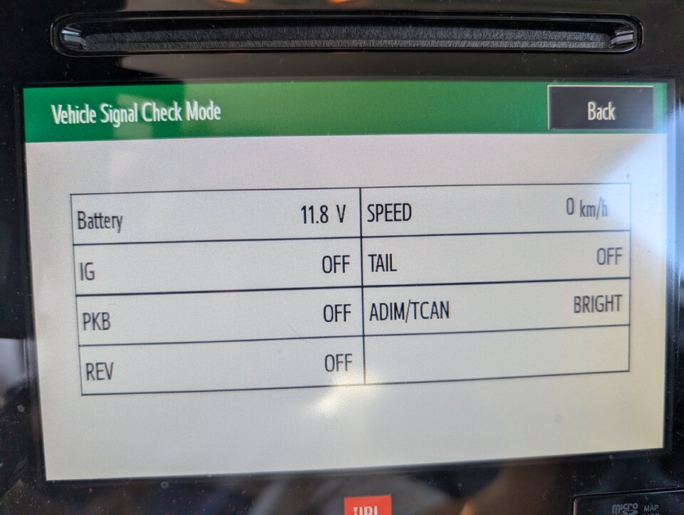

    Looks like this is a 480 CCA battery. I also ran the quick diagnostic check and the battery is at 11.8V, though I must admit it took me about five minutes to figure out how to get into the diag mode!
    So is a loss of 100 CCA troubling enough for me to replace this? I feel bad that I cheaped out and didn't get the AGM Platinum.

    Yeah the battery you've got in there is rated 480 CCA, and getting a measurement of 378 doesn't bode good.
    The best way to measure voltage is with the car OFF, with a digital multimeter, or a battery assesment tool like your first pic. The car's displays require the car to be on, which will likely drop the voltage. Too: voltage is sketchy indicator, measured CCA is more significant. At-rest voltage can bounce around a lot, depending on previous driving, recent charging session, etcetera.
    AGM is not that relevant, Toyota used it primarily due to previous gen batteries being inside the cabin, instead of under the hood. I'd research what the stock battery was, get that or similar spec aftermarket.

    Now that you can check the battery with the diagnosic, Turn on the head lights and see how far the voltage drops. If it drops more than about 0.5 volts, you need to fix the situation.
    Your battery may just need to be charged. Our Prii have a very slow charging mechanism so if you normally drive short trips, the battery never gets fully charged. This is bad for lead acid batteries as the battery plates develop a layer of lead sulfate crystals (lowering the CCA). A desulfating battery Minder (AKA Battery Maintainer) can fix this problem as long as the battery is not too far gone as well as top off the charge level.

    Thank you guys -- OK, ran the second test. When I went back out to the car, the voltage was down to 11.6. I turned the headlights on. It went down to 11.5. Waited a minute, and ran the test again, and the results were the same -- 11.6 to 11.5. What does it mean if it only drops 0.1V?
