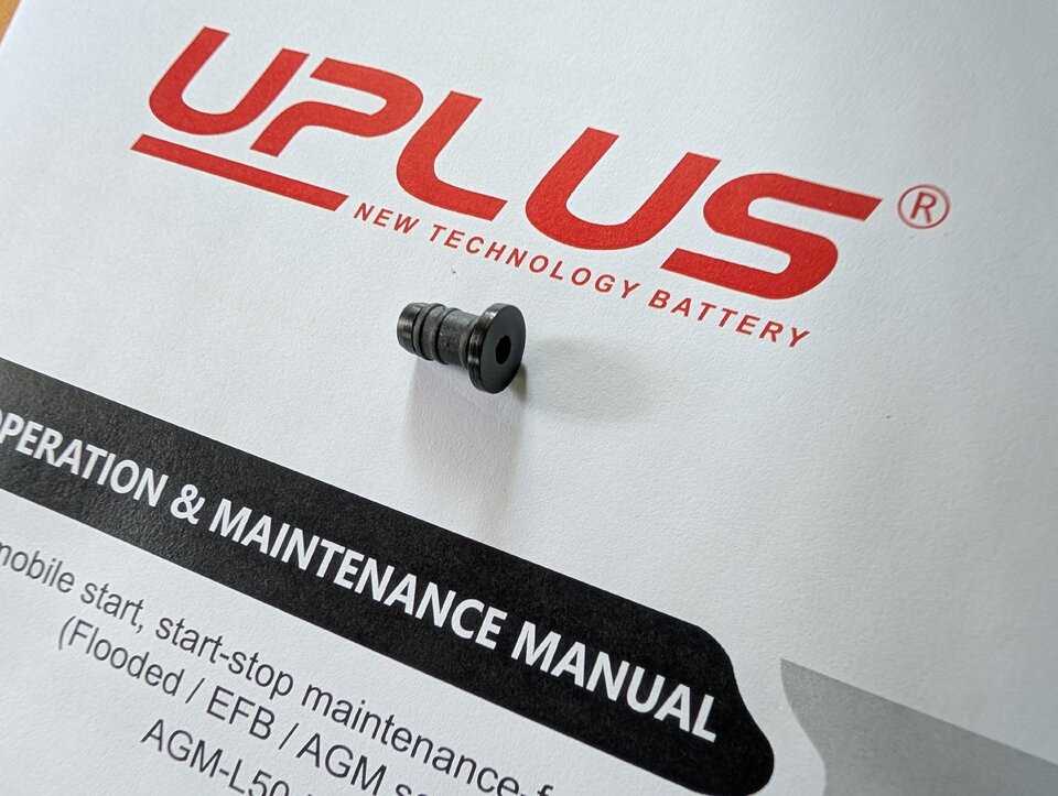

    Okay, battery installed, all is well. The only thing I could not figure out is the black plug that came with the battery. It was in a little plastic bag and stuck under the black terminal plug. Is this important? I could not find anything in the manual. See attached.

    Is it a battery with a port that allows connecting a hose for venting (say, if it were installed in the cabin, like other Prius generations do)?

    Ah, that must be it. There is talk of a vent plug, but this is sitting under the hood so I think I'm fine to leave it as is. Thanks!

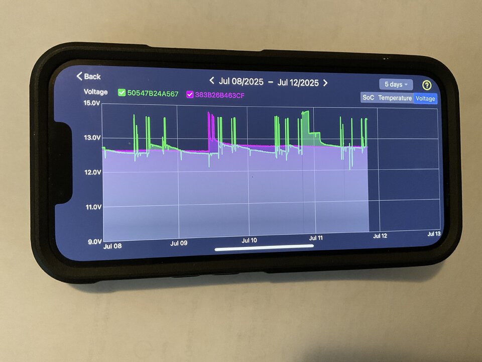

    The only way to know more about your battery is with a monitor. Here is five day graph of voltage activity on my two cars with Ancel monitor. The purple is an alternator vehicle, green my 2020 Prime. There is a period of external charging the 12 v. Prime battery, showing what the charging curve is for that device.
