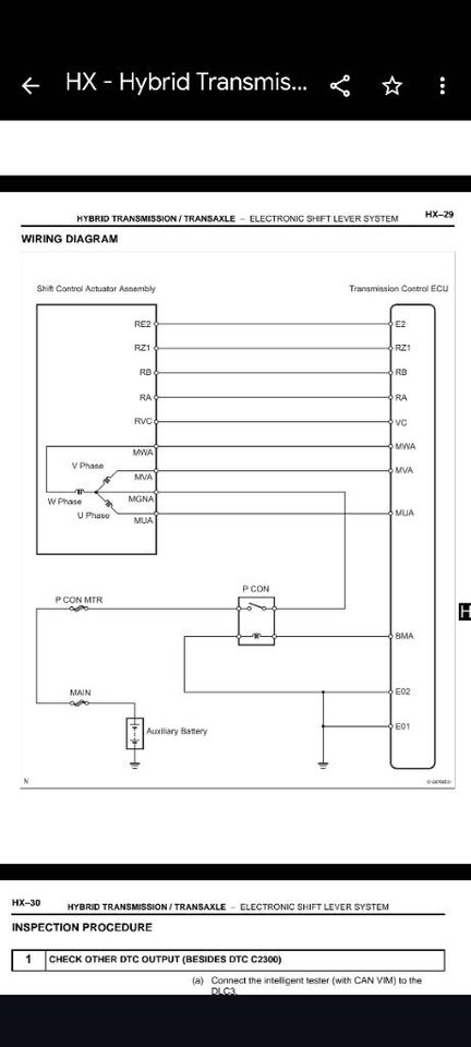

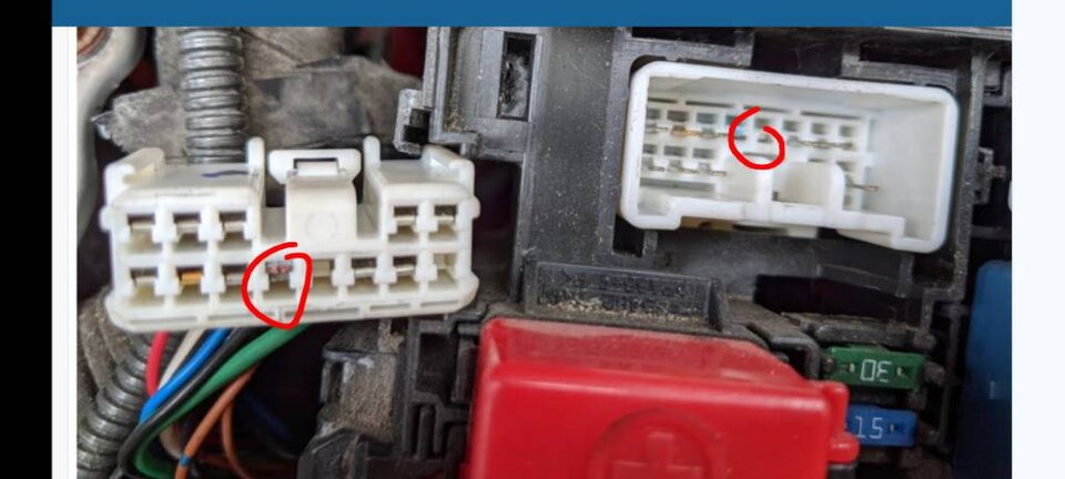

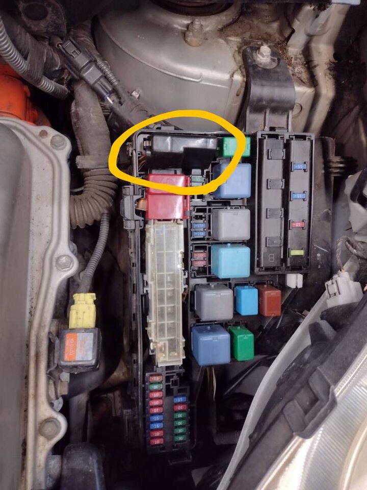

    There's a not uncommon failure on Gen2 where a blue wire in an under hood fuse block connector will corrode. That wire carries battery power from the P-con relay to the parking actuator.
    P3102 is the hybrid control ecu saying "TCM has a problem". C2300 is the TCM saying "I turned on the P-con relay and expected to see 12V at all three actuator motor coil ckts (MUA, MVA, MWA), but I didn't have 12V".

    Thanks for the input @mr_guy_mann! I checked up on this and I'm seeing 12vdc here. My personal Prius, a 2008 (with 400k mi and still going on the original motor) had this issue and I was able to repair that a few years back, so I am familiar with this.
    I did try bypassing the harness incase there is a partial break here by running a temporary jumper wire directly from this panel's socket to the p-lock actuator itself and this didn't help resolve the issue unfortunately... are there any other niche or uncommon failure modes that could contribute to this issue...?

    Okay so I've made some tests. Not as many as I would have wanted to complete but here is what I have confirmed and tried:
    - verified 12v at P-con mtr fuse (30a).
    - verified 12v at P-con mtr relay.
    - verified 12v at P-con main fuse (7.5a).
    - verified P-con main fuse good.
    - verified 12v present at blue wire going down to shift actuator.
    - verified 12v present on thick green wire in same term block (i presume this to be MGNA per the above schematic from Mr_guy_mann).
