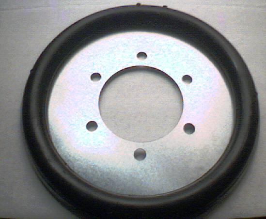

    I used a set of balancing rings that were filled with beads back in the 70's on a 1976 Nova. They worked. The reason I stopped using them and I think why they are not used today is that they cannot compensate beyond a small amount of imbalance and dynamic wheel/tire balancers are much better today than years ago when wheels and tires were "static balanced". In other words, most tires/wheels still need to be balanced with lead weights because more weight is needed than contained in the beads and once a good quality tire/wheel is properly balanced it will usually stay balanced. The beads will compensate for minor imbalance. Below is a picture of a balance ring that is partially filled with beads.

    Dynamic balancing also balances in two planes instead of one like the rings and static balancing do.

    this is not ring!..no comparrision
    this is beads which move around all the tyre as needed...

    Same principle. Same result.
