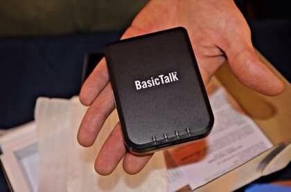

    My wife has not really taken to cellphones and was never a fan of wireless phones. She prefers a POTS instrument. So I picked up a Basic-Talk from WalMart.
    Registration was straight forward. So the next problem was connecting a copper ethernet.
    At home, we're using a T-Mobile "hotspot", G4 cell-to-WiFi unit:
    No copper ethernet interface.
    My first attempt was to use our MacBook sharing the WiFi with the copper ethernet port. No luck, so I switched to an IBM ThinkPad running Debian Linux:
    • NAT - already had it working
    • DHCP - had to add it as the Basic-Talk insists on using bootp/DHCP to get an IP address and address of the DNS interface (i.e., the hot-spot IP)
    • enable ip_forward - the last step, it connected and we're up
    It rides on our broadband and operates a POTS instrument, ring and call. I don't have a caller-ID POTS phone in the house but this is a claimed capability. Too early to call it one way or the other. However, our last phone bill was $30/month and this unit claims less than $10/month. I may have to tweak the DHCP setup and verify a cold start brings everything up. But so far, it looks to be a practical solution.
    For our purposes, a POTS like, cell-phone would meet my wife's expectations. Just transfer the SIM card and have a happy. But 'she who must be obeyed' gave me an ultimatum so the problem has been solved . . . good enough.

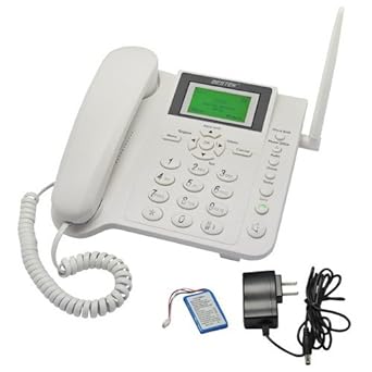

    But in the meanwhile, found this puppy:
    (Bestek Wireless Phone)
    GSM compatible, it works great on T-Mobile. Just transfer the SIM card and voila, a desktop-style, cellphone. Just the thing for folks who want larger digits and 'no cords.' Got mine from Ebay for ~$35 and it looks to be a keeper.
