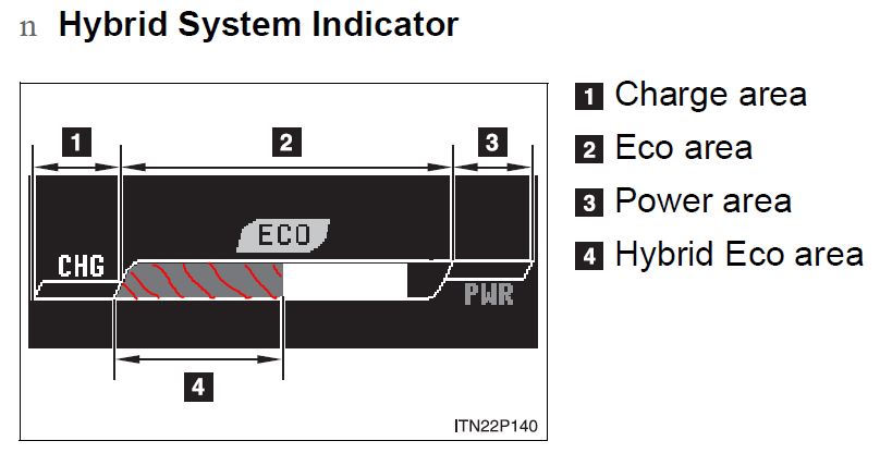

    There might be a problem with your battery, if the state of charge is consistently on the low side.
    OTOH it could your driving style. The main thing that will deplete the charge is purposely getting the car into stealth (electric only propulsion) and then protracted running just below the threshold where the gas engine kicks in.
    The Hybrid System Indicator (HSI) is a good display to use, for keeping an eye on things, if you've not already set it. Once you're in stealth mode, as long as you keep the bar to the left of center, the engine will stay off (unless the battery's really depleted). Your charge will be eaten up fastest when you're near that center point:
    There's nothing wrong with stealth mode, and there's nothing wrong with running the charge down a bit, in my opinion. That's what it's there for. If you put the car in cruise control you'll see it doing the same behaviours. It's mainly a matter of degree, you just don't want to push it too hard.

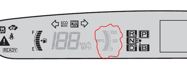

    At normal, around-town town speeds, with engine fully warmed (or close), with a decent state-of-charge, any time you lift right off the gas, then gently re-apply while taking care to stay to the left of that HSI bar center line, you should be in stealth, ie: engine stopped. The in-dash display showing your mpg graph will show mpg up at the top. (I'm assuming you're in the 'States). Step on the gas a little harder, pushing the HSI bar graph past the middle point, and you'll see the mpg graph react, as the engine starts up.
    Note, at highway speeds, do the same behaviours and again that mpg graph will again show bars right up at the top. But in fact the engine will be at least idling (as indicated by a ScanGuage or similar, which can show rpm). I guess the engine's using very little gas though.
    Any time you come to a stop (assume decently warmed up) the engine will shut off. Then when you start rolling again it'll stay off, as long as you're to the left of that HSI bar mid-point. I recall our first test drive of a Prius, getting back to the dealership there was a modest upgrade into their lot. I had to come to a near stop, then started fairly slowly up the ramp. I could hear that engine had stopped when I'd near-stopped, then stayed off going up that ramp. ;)
    Another case in point for me is a multi-story parking garage we use: I'll pull in with decent charge, reach out to get a ticket, then start spiralling up through the levels. It's at low speed and almost without fail the engine stays off. By the time I park the charge is quite a bit lower, or down to two bars (where the engine is forced to fire up).
