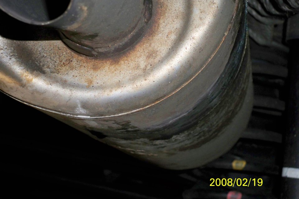

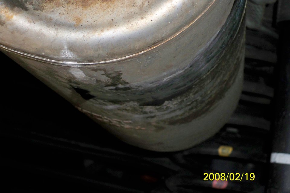

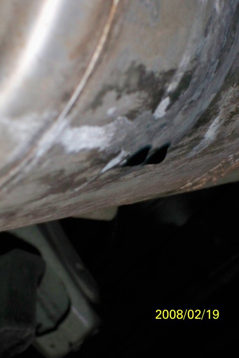

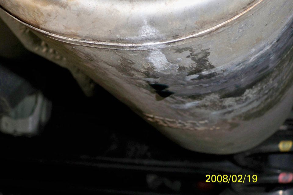

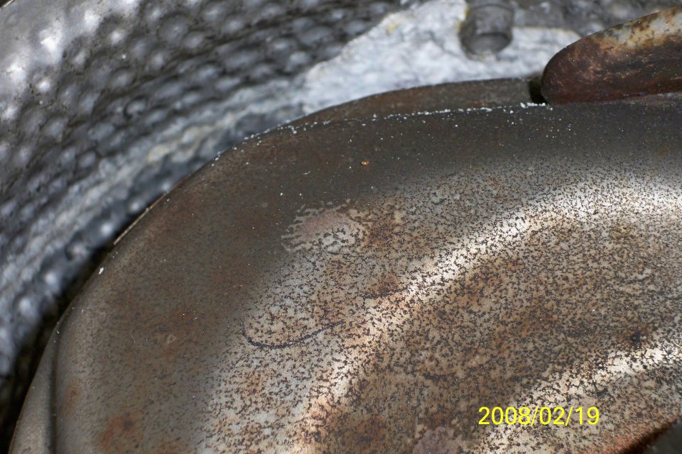

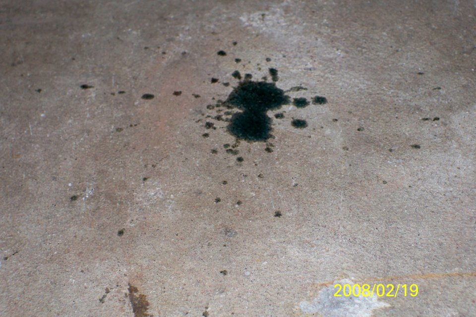

    I checked the fluid level in my battery, all cells were low, I filled all cells 4 days, noticed some white powered on the battery compartment, some moisture on the battery and cleaned the area 4 days ago. Today I noticed some blue moisture on the floor, I looked under the car and the exhaust shield had some white powered substance, muffler had the blue moister in the top and the bottom of the muffler. I than removed the covers in the battery compartment, removed the vent tube from the battery, I than inserted a Philips screw driver thru the hole and it went thru the exhaust shield and onto the muffler.
    What would cause this: overcharging from putting the car in b-mode , bad battery and if I need to replace the battery, what would be the best replacement for a battery

    I'm thinking your frequent top-ups are the cause.

    This sounds like a battery over charging. The only thing that could cause a problem like this would be a shorted cell in the battery or a faulty voltage regulator in the alternator. Change the battery first of all then check the charge voltage. If it is over 14.2 v max then the alternator is running wild.

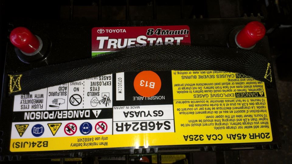

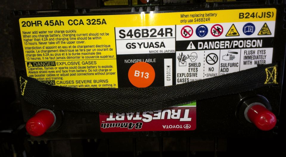

    That's a lot of water.
    Somebody correct me, but I am thinking this batt is not supposed to be filled with water.
    I googled this pic, seems to be from Prius Chat. I don't know if this is your exact batt, but first line says "Never add water". So that could be the problem.
    You want to get a new 12v battery and you are going to have to check for damage that needs to be repaired.
    I checked my Gen2 op manual for info they were silent on adding water to batt. However, my Gen2 repair guide says it is maintenance-free because not much H2 is created when charging. Now that you have added water, it is probably making H2 gases when charging which is potentially unsafe situation.

    As a service for dyslexics:
    WE0H, RRxing, BZzap! and 1 other person like this.

    1,990
    Edmonton Alberta
    The "pads" between the plates should -just- be wet. No liquid above them. You are not seeing the plates, just the "pads" or mats. It's an AGM (absorptive glass mat) battery.
    You have probably lost acid from over-filling the battery. Time for a new battery.
    If you are going to add water, once every two or three years is enough, and add just enough that the "pads" can be seen to be soaked. NO liquid above the "pads" please!
    Hey, that battery in the photo has a warranty! It's got to be good for four years, but probably a pro-rated replacement.

    The battery in the photo is not my battery, the liquid in each was just above the vertical plates and there was plenty of room to add water. This is a wet cell battery, just like any wet cell for any car and this is not an AGM battery. I checked the voltage 14.5 vdc running or not
