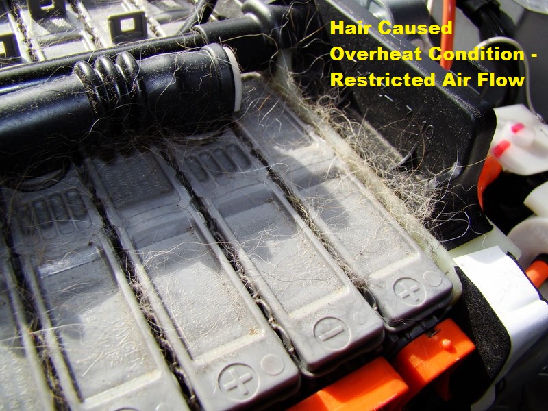

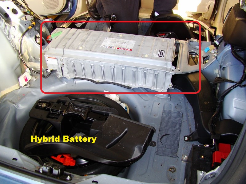

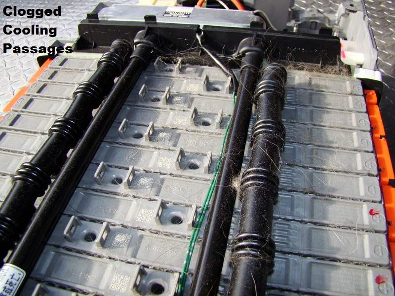

    For now, I will post the photos from diagnostic and the report (after completion). PS dog hair in my car got sucked into the vent connected to the battery cooling fan. Even though my battery died at 177K, it was possible the clogged fan caused the battery to overheat. I wish my battery conked out last year at 140K so I could have had Toyota replace my battery.

    Please do keep us updated. I agree the dog hairs were possibly partly responsible for the demise of your battery. I hope they cleaned out the cooling fan when they worked on your battery.

    Regarding clogged fan: consider putting in a filter (after ensuring the fan's been cleaned).
    I put a piece of vacuum cleaner motor filter in behind our fan inlet grill. I check it periodically with a flash light. So far very little accumulation.
