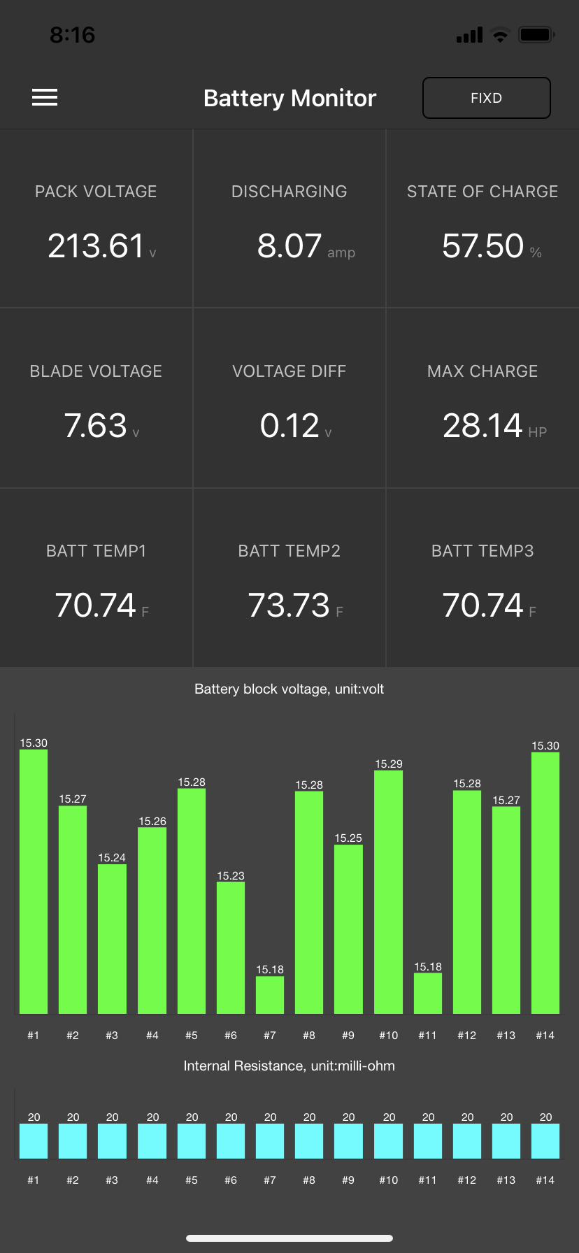

  13. TomLaNa
    TomLaNa Junior Member
    Mar 10, 2021
    43
    Pensacola, Florida
  14. dolj
    dolj Senior Member
    May 14, 2012
    8,646
    4,398
    Wellington, New Zealand
    The top voltage we see normally see is 241 - 242 V and it usually takes 32 - 40 hours to get to the point where the voltage has plateaued and maintains the same voltage for 4 - 6 hours.
    In general, reaching high voltages and/or short charging times are an indication that all may not be well with some modules.
    Having said that, the image in post #53 looks pretty good. Only a difference of 0.12 V between highest and lowest with an 8 A draw.
    #54 dolj, May 13, 2021

  17. TomLaNa
    Mar 10, 2021
    43
    Pensacola, Florida
    The battery has gone through one complete cycle of charging and dis-charging. I assume the #7 & #11 modules are the issue? Is it just a question of replacing those two modules?
  18. dolj
    dolj Senior Member
    May 14, 2012
    8,646
    4,398
    I'd do the complete three cycles then drive the car and monitor. Are you following the HA process? Especially the target voltages of each discharge – 134 V, 101 V, and 84 V?
    I'm not saying there is any issue especially based on just one screenshot. The way Dr. Prius graphs the voltages (of which I'm not a fan) exaggerates the difference. To keep it in perspective you have one-tenth of a volt difference between your highest and your lowest blocks. This is well within spec.
    See how it looks after another two cycles and remember to finish with a final full (unhurried) charge. It will be interesting to see what the voltage tops out at in the successive charges.
    This is a process that shouldn't be hurried.
    TomLaNa likes this.
