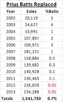

    Congrats. We don't really know how HV batt age/miles figures into life. Gotta believe internally Toyota has a great data base with lots of trends, but I presume it is proprietary.
    Lately I am wondering if there is a population of less reliable batts that fail, say 10%, and the others keep on trucking. But that's just unscientific observation about how it seems to go with posts here. Right now we seem to have a slug of 2007's going bad, next year at this time it'll be 2008's.
    Should yours fail unexpectedly, be sure to check posts here for how to contact Toyota for better deal which they give sometimes even out of warranty.
    Consumer Reports prior survey (2-3 years old now)
