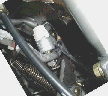

    It's the Brake Switch that under the Brake Pedal.
    I onced had the issue, thought it's the ECU or Traction Battery.. ended.. it's the brake switch which doesn't like up at the rear and so, ECU will not turn the car to "Ready" mode.
    Go and check it out.[​IMG]

    5) Did the mechanic check the brake switch for contact as mentioned above?
