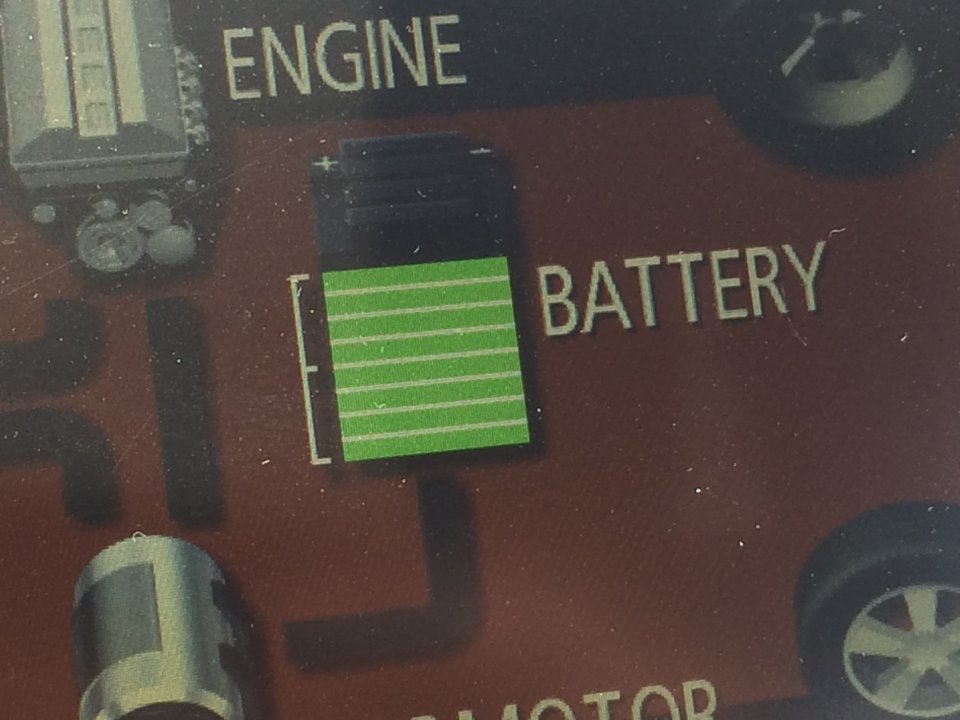

    Flatlanders may never see the top bar displayed. The car is saving some room for regeneration on significant downhills, such as the immediate 400 foot descent on one of the routes away from my house.
    3MCS1DJ and edthefox5 like this.

    I thought I had even read somewhere that the top bar never fills. I live in the flat state of Nebraska (means flat water in Oto Indian) and I was so surprised to see it filled the other day that I took a picture :).
    3MCS1DJ likes this.

    Yep like Fuzzy says us Flatlanders have never seen that last green bar. My car has never seen a big hill.
    3MCS1DJ likes this.

  12. You'd have to be braking down a really long downhill (lots of time in the CHG) and then it will go to the full 8 bars.
    Just getting to 7 bars is normal. (Also not seeing below 2 bars I think is normal.)
