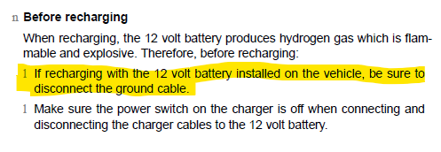

  12. Mendel Leisk
    61,527
    42,343
    My Gen 3 manual says this:
    Which I've never done. :unsure:
    #72 Mendel Leisk, Jul 28, 2025
    Gokhan and BiomedO1 like this.
  13. BiomedO1
    BiomedO1 Senior Member
    Mar 27, 2021
    4,592
    2,409
    Left Coast
    But are you using an old school battery charger or one of those high frequency pulse battery desulfator / refurbisher?
    As stated earlier, you can probably get away with it - until you don't and fry something. The simplest thing to do is, turn-off and don't use that option or disconnect one of your cables. It's your car and you can do whatever you want to it.
    I know a lot of people, professionals included, who jump start a car by connecting battery terminal to battery terminal - NOT to engine block or other ground point. They can get away with that, but what happens in that 1 in 1000 chance that the battery explodes in their face? Not worth it to me, I prefer to do it the correct way - but that's just me....
    PS, the Toyota manual states that so they don't get sued in that 1 in 1000 chance.
  14. Gokhan
    Gokhan Senior Member
    Oct 5, 2008
    6,714
    2,670
    Paramount CA
    You can turn off the battery maintainer before you remove the wires, which eliminates any spark hazard, the latter of which is the reason for the note in the owner’s manual.
