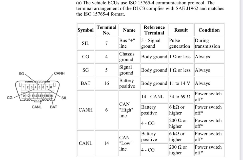

    A low current solar charger could be connected into an obd2 port or you could install a piggyback fuse and effectively hardwire into the 7.5 amp obd2 interior fuse or one of the 10a or 15a fuses that stayed energized.
