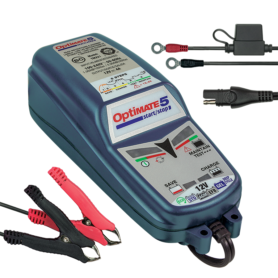

    As my battery reached 12.3V I ordered OptiMate 5 Start/Stop charger, deionized water and will give it a go.
    @DG Bear thanks for sharing. Also, a few posters above said that they will update how long they extended the battery life. I ask out of curiosity.

  19. Fostel
    Fostel Member
    Oct 30, 2018
    96
    29
    Kent
    Excel
    Mine may be weak as it was never topped up but not dead completely. I shall see when the charger arrives.
  20. sam spade 2
    sam spade 2 Senior Member
    Mar 31, 2018
    7,035
    2,801
    2017 Prius c
    A short term improvement often is possible just with a "plain" charger, meaning a few weeks or months.
    But that doesn't hardly qualify as a "revival".
    The charger you ordered probably is just an automatic smart charger with a fancy face.
    Just don't expect a miracle.
