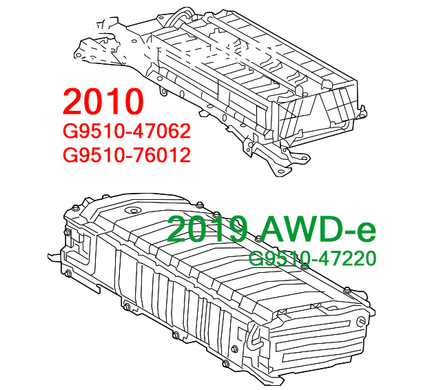

    Sir Can I use 2019 hybrid battery pack on my 2010 prius?
  15. Mr. F
    Mr. F Active Member
    Sep 21, 2020
    390
    264
    Washington
    It would have to be an AWD version of the 2019 since only those used NiMH modules.
    Looking at the diagrams, it also does not seem like the entire assembly would be physically compatible with a 2010. The best you could do is transplant the modules, but only from an AWD Prius.

    What @Mr. F said. Also, you can't just put in the pack because the cases are totally different. You need to transplant all the modules from the new battery to the old one.
