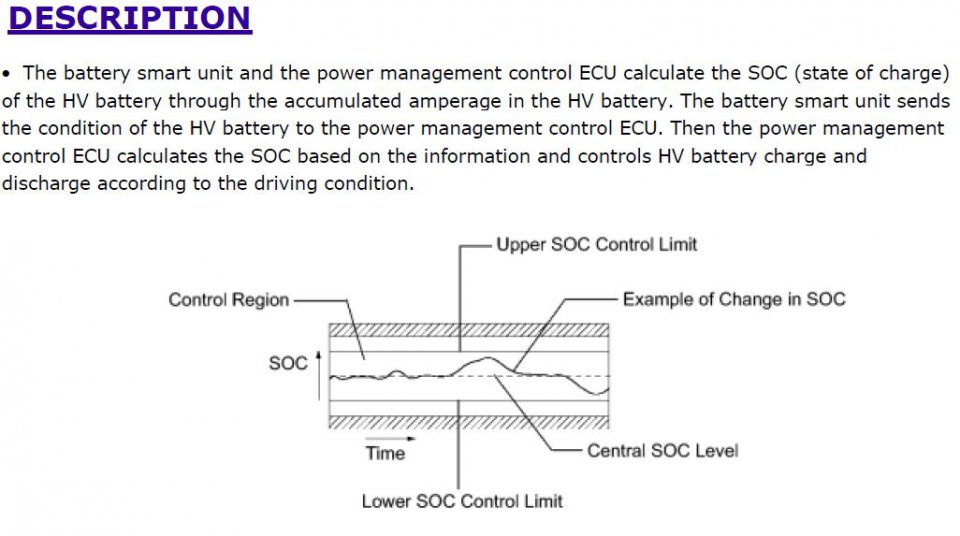

  10. Les_PL
    Les_PL Active Member
    Nov 11, 2012
    317
    249
    Gdynia, PL
    Here is an illustration of the above :) It is all OK with your car.
