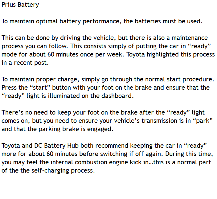

    Then I read about putting the car in "Ready Mode" and letting it run for an hour about once a week. I am posting a picture of what I read for you.
    I am thrilled about that option, at least for in winter. I told my daughter and son-in-law that I had already done that a few times. They were really upset with me and they talked to a mechanic at the Toyota dealership and he said I could ruin the battery doing that.
    When I read that article on here, it had said that the Prius battery was made just so you could do that, but of course I didn't copy that part off and I don't have the link. I have hunted for the link for several days.
    Could someone here please talk to me about this? Is this information correct and does it harm the car?

    I see that my picture did not post, so here is what it said:
    "Prius Battery
    To maintain optimal battery performance, the batteries must be used.
    This can be done by driving the vehicle, but there is also a maintenance process you can follow. This consists simply of putting the car in "ready" mode for about 60 minutes once per week. Toyota highlighted this process in a recent post.
    To maintain proper charge, simply go through the normal start procedure. Press the "start" button with your foot on the brake and ensure that the "ready" light is illuminated on the dashboard.
    There's no need to keep your foot on the brake after the "ready" light comes on, but you need to ensure your vehicle's transmission is in "park" and the parking brake is engaged.
    Toyota and DC Battery Hub both recommend keeping the car in "ready" mode for about 60 minutes before switching it off again. During this time, you may feel the internal combustion engine kick in...this is a normal part of the self-charging process."

    You son-in-law, daughter and Toyota Stealership are wrong about harming your battery. Prius are used in that way by lots of people. However it's not a very effective way to charge the 12v. You need to get yourself a legitimate battery charger like this one: https://www.ebay.com/itm/354203591176 And periodically park your car close to an outlet so you can charge it!

    letting the car sit in ready is absolutely not a problem.
    many here have been doing it for days at a time to sleep inside.

    Just putting the car in READY, as she would be doing to charge up the 12 volt battery anyway, will bring the traction battery up to a decent state of charge as the very first thing before the engine cycles off.
    That's all the traction battery needs. It gains no further benefit from Italian tune ups.
