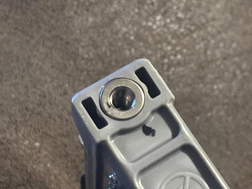

  8. ChapmanF
    28,638
    18,960
    Don't the screws go into threaded metal inserts? :)

    I don't think so it looks straight into plastic to me and my battery thinks same . I've gotta module in hand a good one . If I can find a bad I'll scrape the plastic and see if metal under plastic . But I don't see silver or gold color just grey looking sched 80nplastic look

    319
    Yes, they certainly do. And if someone doesn't know that answer, yet claim to know about the HV batteries, well, not much good to say about that.

    Gen 1, Gen 2, Gen 3, Gen 4, Gen 5 NiMH modules all have steel threaded inserts on the bottom for those fasteners. Gen 1 has two, one on each end. The other Gens have only one, under the positive terminal end of the module. Since the modules interlock, there is no real advantage to having two on each module. here's a photo.
