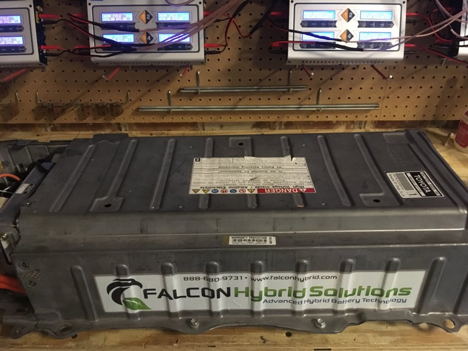

    Here is an interesting thread by one of the hobbyists here. He starts off my evaluating a failed Falcon Hybrid rebuilt battery.
    Just Another HV Battery Thread and Experiments | PriusChat
