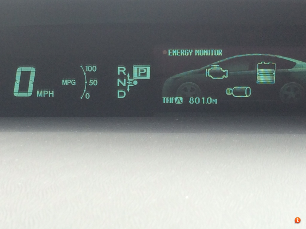

    Jus bought her Friday and my battery has never reached a full charge and has stayed a few bars below or one more bar above where its at now

    This seems quite normal, it will never reach a full charge unless you are going downhill for 5 miles straight. It MIGHT at that time go completely full.

    6 bars, that is exactly where the car tries to keep.
    You don't list a location. Many flatlanders will never see the top bar. If you are in Florida, the highest 'mountain' descent probably is not be enough to push it all the way to the top.

    I agree with the other posters. Nothing to worry about. The Prius hybrid system is designed to keep from "filling" up the battery. At 6 bars it really is only about 65% full. At 8 bars (Top of Battery in Display) the battery is only 80% full. Toyota designed the system to not fill the traction battery more than 80% or drain it less that 40%. This promotes battery longevity. That is why you will read posters saying deep discharges of the traction battery excessively or completely filling the traction battery excessively is not good for the battery. For best longevity it is suggested to keep the battery basically somewhere around 60 to 80%. That does not mean to freak out if you see two bars either. The Prius computer system will take care of the traction battery for you. It will automatically turn on the ICE (gas engine) as needed to recharge the battery IF it gets to 40% or below. Also, if you get it above 80% the ICE will begin to run a little faster than normal while the system bleeds off the excess current. This will happen if you go down a long mountain road and fill up the battery. It will sound like the engine is racing and revving up real high. Again, don't worry about it. It is all normal. To sum it up, the battery is the least of your worries with the Prius.
