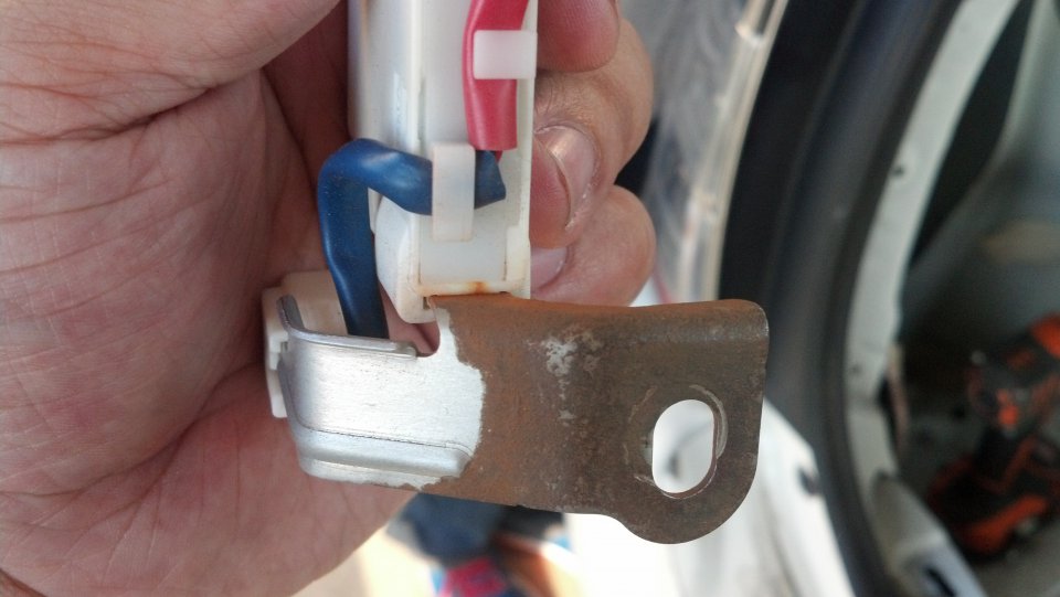

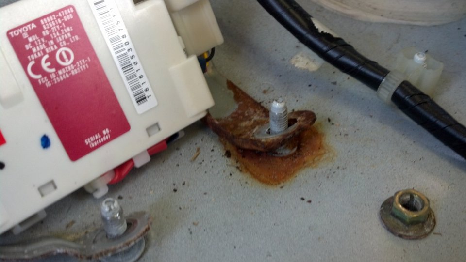

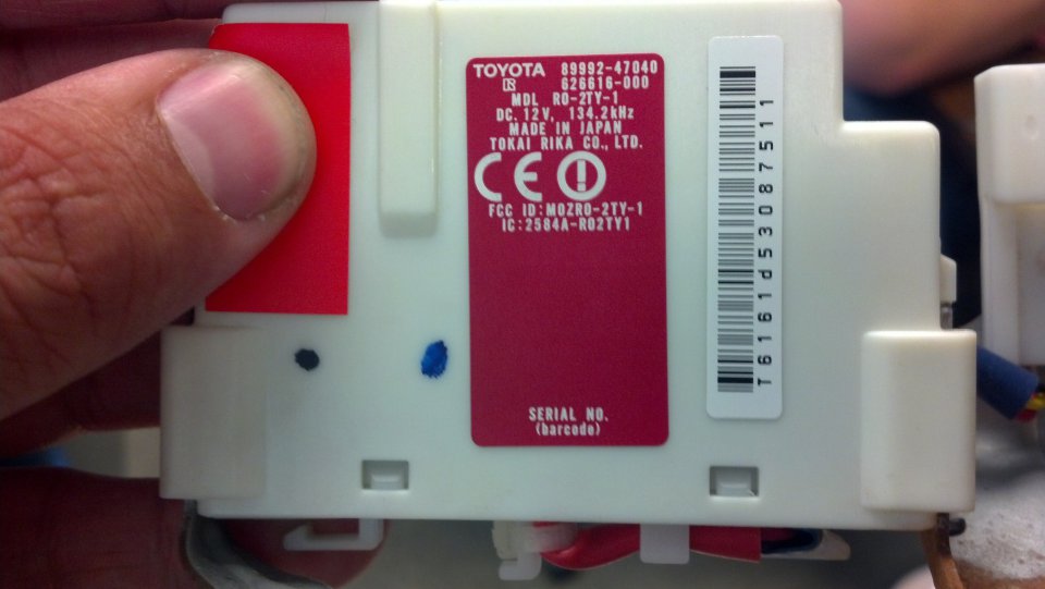

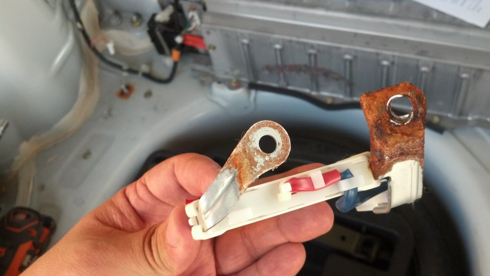

    UPDATE: After testing the battery voltage, relays, and resistors none of those are what's causing the check hybrid system light to come on. Also, after checking for corrosion in other parts of the car, it appears that it is limited to the places seen in pictures I posted earlier, which was near the smart key system and in an area that was collecting sand underneath the seats.
    I'm starting to think the smart key system might be to blame for this light. It has very concentrated rust around the component, and is not functioning correctly in the car. Pictures are posted below.

    DTC P3004 is not going to be caused by the Smart system. Your hybrid system has a problem.
    Greg Grieve likes this.

    The corrosion on the smartkey antennae mounts won't hurt anything. That antenna does not need to be grounded.
    (although it's looking like the back of the car was underwater at some point, or exposed to salty sea air for an extended period).
    Greg Grieve and Andyprius1 like this.
