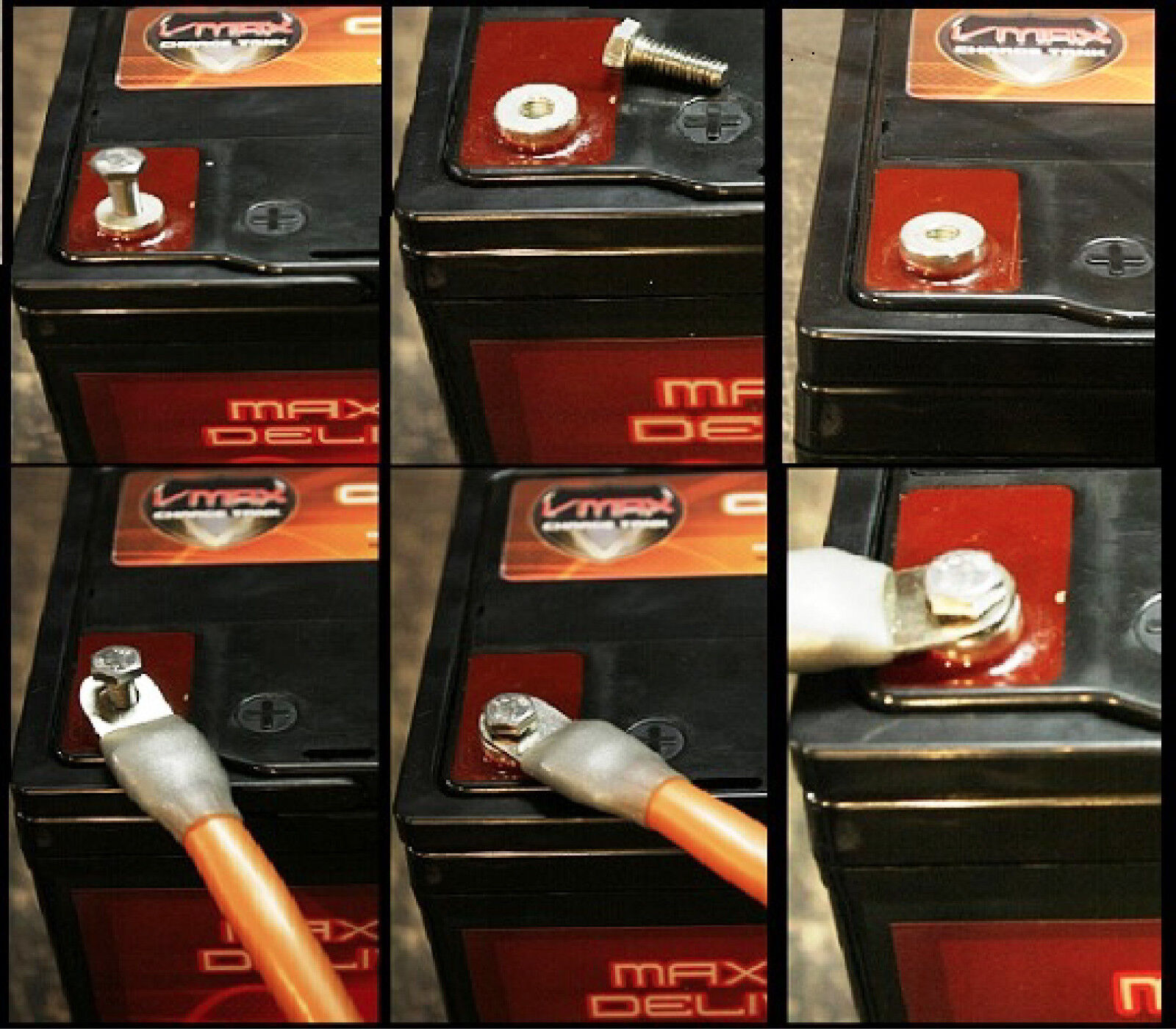

    Greetings, We own a 2012 Prius, and I believe our 12v car battery is on its way out.
    I have done some research on line for replacement batteries, and cost is a serious issue for us because we are retired and live on a fixed income (SS) which honestly stinks. lol
    I read an article and at the end (in the comments section), a gentleman made mention that he used a VMAX MB857-35 12V AGM group U1maint free battery, rather than any of the alternatives, and this saved him 50% off the average price of 200 bucks.
    My concern is, how would I you modify the battery posts to make the battery cables fit?

    Proper cable connections or adapters might be a better question for the manufacturer. Does it have a hose connection to vent the hydrogen? That would be my concern.
