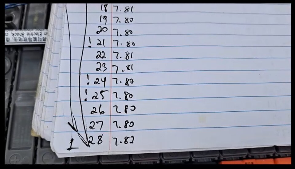

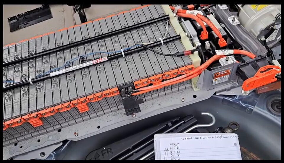

    The biggest mistake a prius owner can make is to replace a hybrid battery with only 50k miles for something questionable.
    These error codes may not mean anything after using the Hybrid Automotive charger and my fluorescent bulbs discharger.
    Here is an example of how a battery with 3 weak modules and trouble codes turned into a completely working one.
    2011 Prius with 156k miles.
    Delta SOC 39.5%
    3 weak modules with exclamation marks. The voltage was lower than on the other modules in the pack.
    The voltage of these 3 modules after discharging the battery pack in the car to 40%, after using the Hybrid Automotive equipment. The whole battery was discharged 3 times to 3.8, 78 and 13.9 volts. The order of these voltages is not important. This is how I managed to discharge that battery. The most important voltage here, for this battery is 3.8 volts. Discharging it to 80 volts, as stated in the instructions from Hybrid Automotive, would not have fixed this battery.
    I saw that prius today (a month later) and MPG was 46.1.
