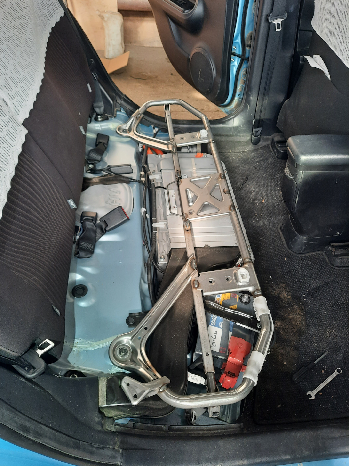

    Hi all. Just following up with a question I hope some can answer. Do I have to remove the entire hybrid battery to get the cover off and inspect the temp sensor wiring? I don't mind trying to just get the cover off, if we can get some milder days. But taking the entire battery out will be a logistical challenge since I don't have a garage or place to work on it. Thanks for any info provided.

    It's easier to remove the cover than to get to the battery under the seat.
    When you see this picture, you'll understand which wires are damaged. A mouse probably couldn't get inside the battery.
