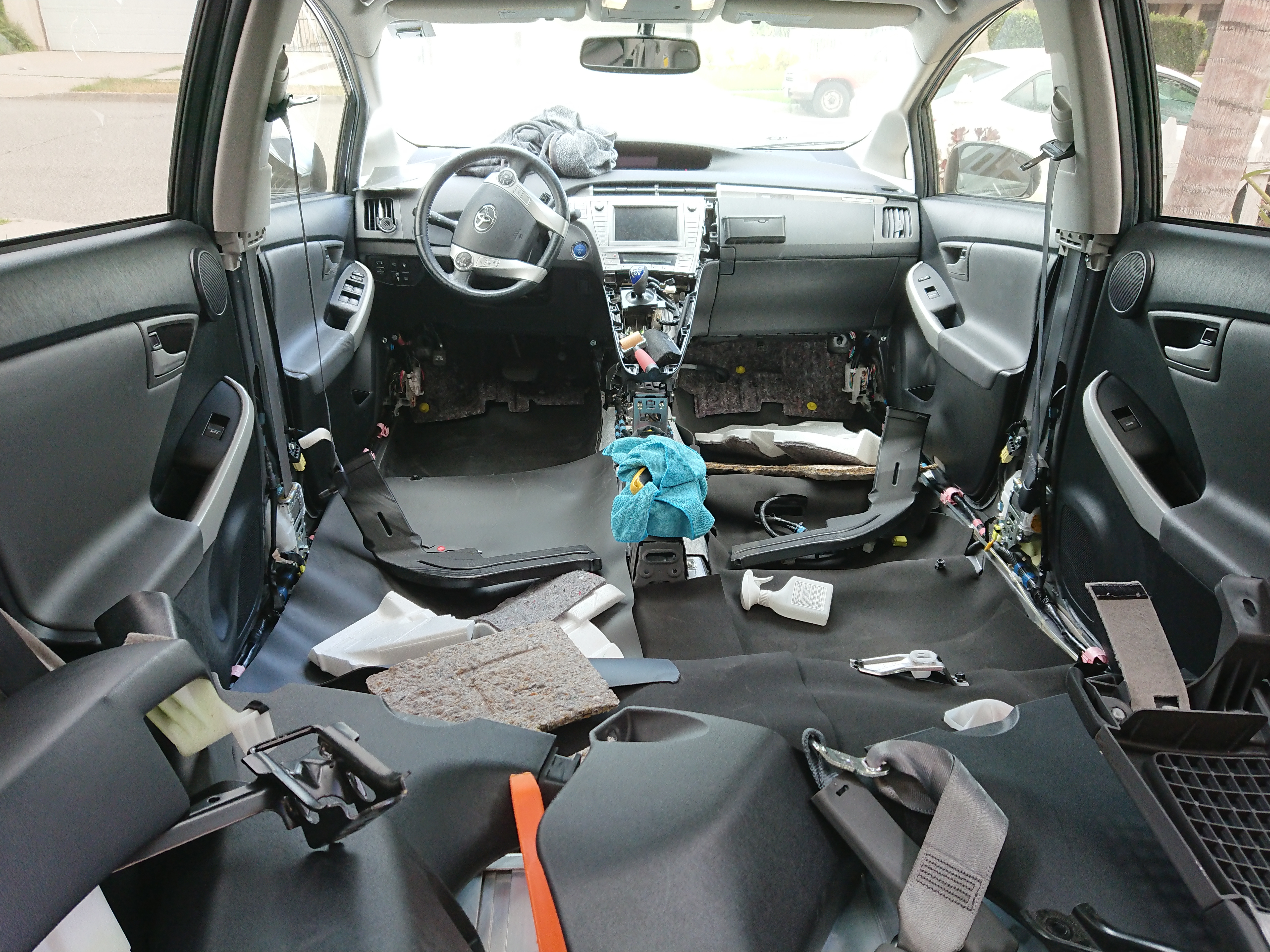

    I did the the full car using the package from Sound Deadeners Showdown. Took a few days to do but I'm very pleased with the results. Sure, it adds about 80~100LB of dead weight but it wasn't enough to notice my mpg drop.
    I actually have a small bit of materials left over if you're interested in for a discount. I have like 2 boxes of CLD tiles, a small roll of MLV, CCF, melamine foam, etc.

    Nice work! Please post lots more pics... I'm especially interested in how you end up re-doing the dashboard with the new sound system, as well as how you redo the door panels and roof...

    I didn't take too many pictures but it's all pretty straight forward. I didn't do the dashboard so I can't help you there. I did full door, trunk lid, trunk, floor, roof, everything that is reasonable.
