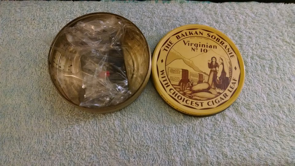

    …not quite on the biblical scale normally associated with that introduction, but still mighty strange to me. This afternoon I decided to experiment with my SKS fobs to see how effective their operating range is, and one of the experiments was to place the fob in a static-bag, and check to see if the car and fob could see each other (well, according to what I've read here-abouts the fob should be screened, right?) WRONG!!! I tried putting the fob in one, then two, then three anti-static bags (see picture), and the communication wasn't compromised in the slightest! :eek: o_O :confused::confused::confused:

    Maybe the answer will have something to do with anti-static bags being made slightly conductive (enough to drain off large static charges that could zap electronics that you store inside them), but not really conductive enough to qualify as Faraday cages. You might repeat the experiment with your fob wrapped in aluminium foil, or in a metal cookie tin with a tight-fitting cover, and report if those results are different.

    Thanks, Chap! Nice one! I dug out an old baccy tin, and just tried it, and it worked like a charm!
    (…still can't upload files though! :confused::confused:o_O)
    (…tries again!)
    Hallelujah! It works! :D

    Static bags just protect against static, don't shield radio transmissions? I do know carefully wrapping my fob in a double layer of aluminum foil did the trick.

    Tin foil or an EZ-Pass RF shielded bag will work.

    …well, just for shyts n' grins I tried it using the EZ-Pass RF shielded baggy which my replacement transponder arrived in, but unfortunately it had no discernible effect.
    Here's how I tested it:
    1) I left the unshielded FOB inside the car (on the driver's seat) and tried to lock the door (using the button on the driver's arm rest). The locks would operate, but when I closed the door, the doors would unlock)
    2) I tried (1) but with the FOB inside the EZ-Pass RF shielded baggy - The locks would operate, but when I closed the door, the doors would unlock!
    3) I tried (1) but with the FOB inside the baccy-tin (see threads passim^^^^^^^^) - The locks would operate and stay locked when I closed the door.
    Hooray for Balkan Sobranie! :)

    All I can say, is years ago I experimented with the foil wrapped fob and the fob in a metal Altoids tin, and I could never get it to NOT communicate.
    It always seemed to work.
    Just for kicks, I keep my back-up fob wrapped in aluminum foil and stored in an altoids tin, but last time I experimented with it? It didn't really help.
