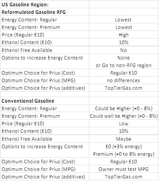

    The table below sums up my personal understanding of U.S. gasoline differences.
    >>In all cases, Regular E10 TopTierGas.com is the best choice for lowest cost and good additives.
    Maximum MPG is a little more complicated, and will generally cost you lots more, with one "exciting" exception:
    If you live in a RFG region, you are paying the highest possible price for the lowest possible energy content. The advantage of this is cleaner burning RFG gasoline. But if you fill up in another region with Regular E10 non-RFG, you could possibly pay a lot less for a higher energy content gasoline. Presumably due to the Prius's SULEV CARB emissions controls, there is not too much eco-downside for using non-RFG.
    My understanding (USA only):

    Lead had nothing to do with "clean air"; quite the opposite in fact.
    The answer is: It doesn't. In areas with the most stringent EPA requirements for emissions, it can't be legally sold......at least not for highway use anyway.
    Your reckoning is missing a critical detail.
    The statement is: E10 contains about 3% less energy that E0.
    You arrive at that figure because the ethanol itself has about 30% less energy.
    The math is 10% of 30% which is 3%.

    I think that is a good point - if you live in non-RFG area, then gaso "may contain ethanol up to 10%", whereas if you live in a ethanol mandate or RFG state then it must "contain 10% ethanol". Yet another reason for me to get out of my RFG area. With the heavy ethanol quotas today, one would think E10 in Regular is harder to avoid, but not sure. Seems clear the new BP Mid-Grade E0 in the Carolinas could be easily made into Premium by adding ethanol, if so then the Mid-Grade could be the energy content "maximum" though probably not cheaper per mile than Regular.
