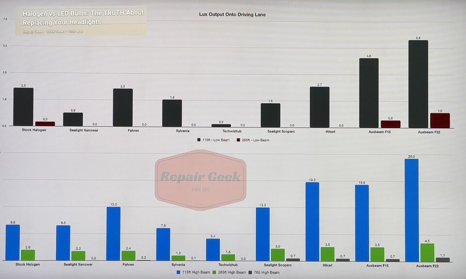

    Repair Geek youtube channel recently reviewed current LEDs vs Halogens. Most of the LEDs were dimmer than halogen at 265ft running low beam with a couple of notable exceptions from Auxbeam.
    IMG_0284.jpeg In this chart from the video, the Low and High beam Lux strengths are compared.
