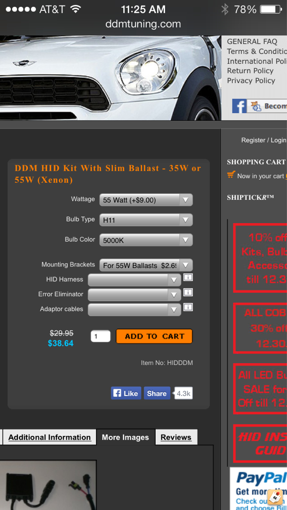

    I'm trying to get 55w from DDM for my 2014 Prius.
    1. Anyone know if I need the bracket, hid harness, error eliminator and adaptor cable?
    2. Is this kit comes with the relay?
    Turn off signatures in Tapatalk Tapatalk

    Not sure but if you have the money, you should look at Theretrofitsource.com
    I had a few questions and they were great about helping me pick the best setup. They said the 55 watt bulb may run hot and not last as long. I just got the 35w with XB35 (H11) super bulbs and 2 ballast, relay harness from them and it is good quality and they have exilent support. But no clue about the ones you asked about.

    I belief the error eliminator would be for the car that tells you if a bulb is out. needed to trick system to not throw bulb out light . you should have the H11 cable so you dont need the adaptor. But I am only making an uneducated guess bassed on what I had to get
