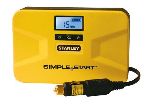

    I use one of these:
    It also needs an extra part to work, because the lighter socket is dead when the power is off. You have to connect it to the jumper terminal located under the hood:
    It's a fraction of the weight and bulk of most units which use lead-acid gel-cells, but has a similar-capacity lithium-ion battery. I like that it stows in the pocket between the passenger seat and door. I don't need one with a compressor on it, because I got one with the car, as part of the handy-dandy flat "flat-repair" kit. It tends to hold a good charge for many months, and it's also capable of starting a conventional vehicle. All-in-all a reliable solution for my application.
    "Use" is not really the appropriate word, because now that I understand the system, I probably won't need to use it. I discovered that the acc-mode times out after 20 mins or so, which is fine for protecting a reasonably good aux battery from going flat.
    My problem was that when I first got my car, my aux battery was going dead after about 10 mins on acc. My car was then dead in the water despite having over 4 kWh of energy on-board. The dealer tested the battery, found it defective and had it replaced.
