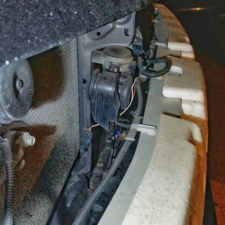

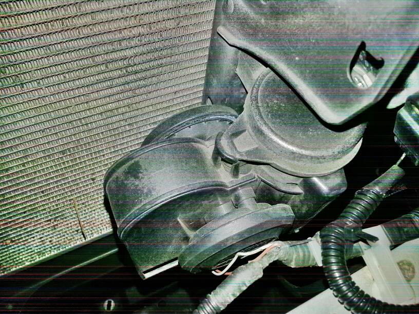

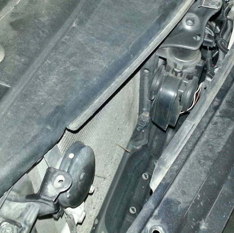

    Hey... Justdidit how did you mount your horn? Looking to do this before the years over. I put one on my dads 3rd generation last night and had to make a custom bracket to mount it.

    Bolted to center bracket support...kinda bad pictures..

    Darn... Didn't think to try mounting it like that using the side vs the top hole that I used.
