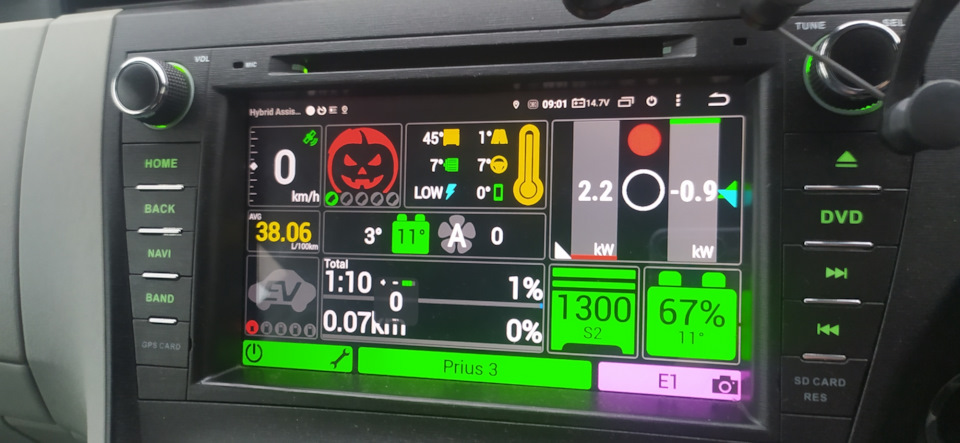

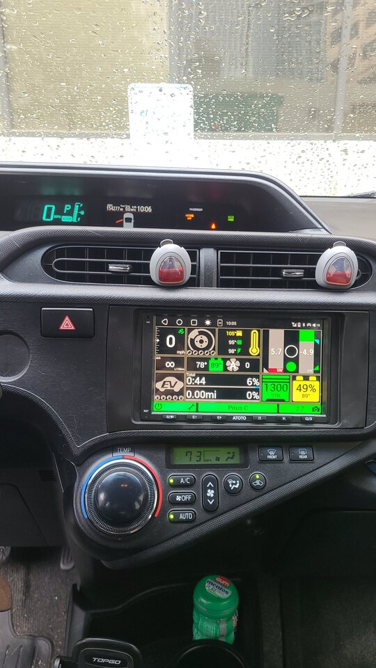

    The program is installed on an Android device. This can be a phone, tablet or car head unit built on the Android platform.
    For example, two photos of a Prius C and a Prius Gen3 with Android head units.

    So can you download the app to your car, or do I need to run it through Android Auto every time?

    When your head unit is on the Android platform, you can download this application and make the necessary settings.
    If the device is on a different operating system, it will not work.
    In addition, the program may not partially support data exchange protocols with some hybrids.
