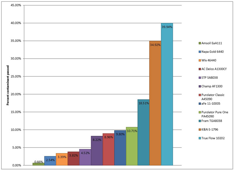

    An anti-drainback valve is nothing special. All spinon filters have that, even the cheap $3 ones (it's old tech). I've never owned a car that didn't have a drainback valve, either in the filter itself, or the engine.
    This test using ISO standard specification shows how poorly OEM oil filters perform. The best filters Purolator, Mobil, Fram, Wix, Baldwin, et cetera have 98% or better efficiency at this size particle. The Toyota, Honda, etc filters are poor.

    Not all oil filters have the valve, who conducted this test?

    The top graph was performed by Amsoil using an ISO standard test. For the sake of completion, here are some more air & oil filter tests:
